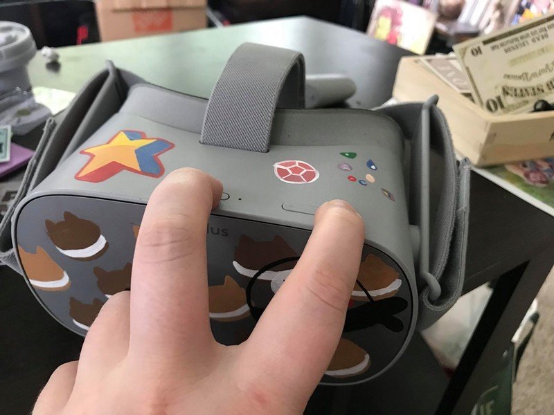

- Turn off your Oculus Go.
- Hold the power and volume down button on your headset at the same time until the boot screen loads on your headset.
- Use the volume buttons on your headset to highlight Factory Reset and press the power button.
- Login to the Oculus app with the account you'd like to connect to your Oculus Go headset and set your device up from scratch.
Hopefully, there was only an error in the files when you attempted your first Factory Reset. By forcing the device to reset once more you might be able to reset the drivers to not give you any further issues. If these steps didn't work for you, for whatever reason, continue on to try to factory reset with your phone instead. You might be able to get a response from there.
