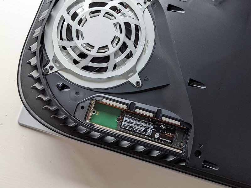

  1. The metal spacer is to be installed in one of the cutouts, depending on the size of your SSD. You'll have to match it up depending on what you buy, but the 80 mark is where you'll be if you bought a standard size PC SSD.
  2. Insert the SSD at an angle into the slot and push gently until it doesn't move anymore.
Source: Android Central (Image credit: Source: Android Central)
  1. Push the SSD down and fix it with the retaining screw.
  1. Reinsert the metal panel and screw it back in.
  2. To reattach the PS5 cover, carefully line up the lugs and slide it up from the base towards the fan while pushing down until it clicks into place.

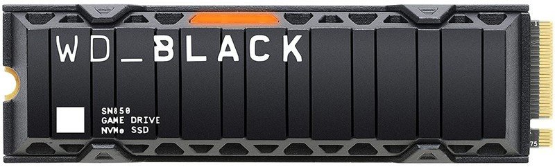

It's also worth noting that you can and should use a heatsink with your SSD. Sony does not recommend using an SSD without a heatsink as it would overheat the system. Better yet, buy an SSD with a heatsink already installed.

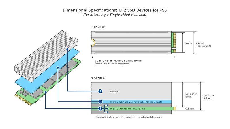

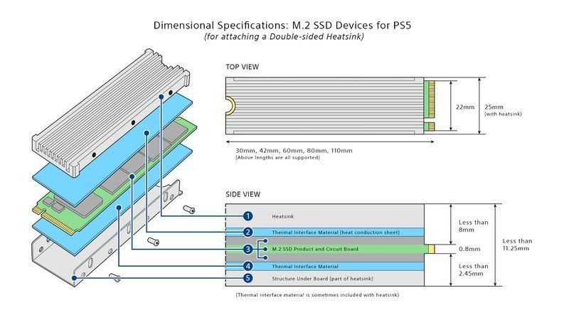

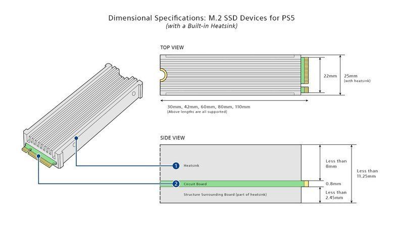

Sony's detailed which internal SSDs will be compatible with the PS5, and it's likely to be confusing for people unfamiliar with the technology. You'll need to get the exact specifications and sizes correct, and even then Sony cannot guarantee that third-party SSDs meeting all requirements will work (though this is likely just Sony being extra careful and covering its back). The company also notes that any internal SSD added may not provide the exact same performance that the PS5's built-in SSD does.
Swipe to scroll horizontally
SpecRequirements
InterfacePCIe Gen4 x4 M.2 NVMe SSD
Capacity250GB – 4TB
Cooling structureHeatsink (single or double-sided)
Sequential read speed5,500MB/s or faster
Module width22mm width
Form factorM.2 type 2230, 2242, 2260, 2280 and 22110
Socket sizeSocket 3 (Key M)
Length30mm, 42mm, 60mm, 80mm, 110mm
HeightLess than 11.25mm
Total size w/ cooling structureSmaller than 110mm (L) x 25mm (W) x 11.25mm (H)

We've compiled a list of the best SSDs for PS5 that you should check out. Among these are the WD Black SN850 and Seagate FireCuda 530, both which work excellent with the PS5. Another brand of note to check out is Samsung.
