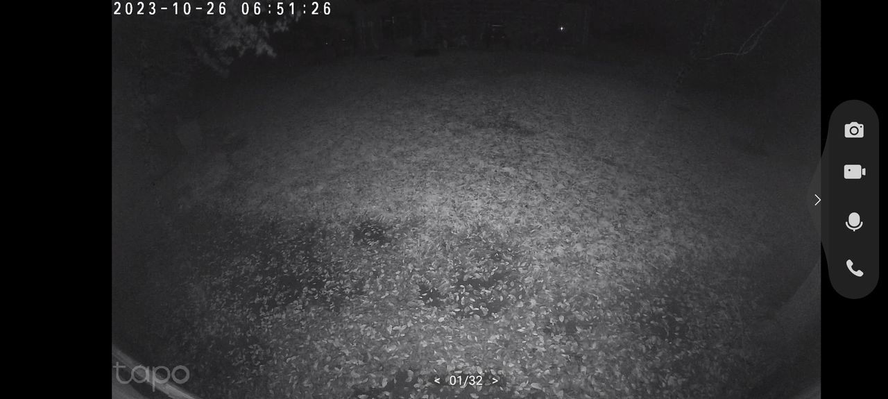

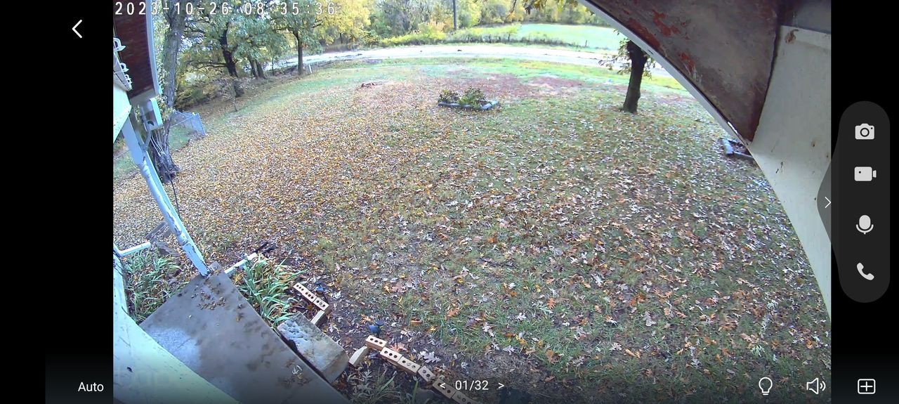

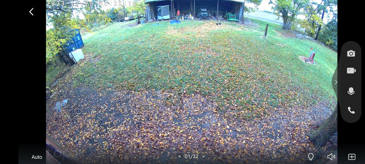

OK, so the camera is set up, and you've customized your settings. Now, how is the video quality? Well, the 2K resolution sensor produces pretty crisp video in daylight. The colors and feed look pretty good. There is an option in the app to set the framerate for the video feed to either 15fps, 20fps, or 30fps.

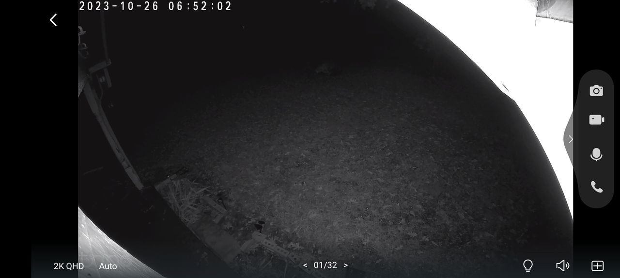

Where the video quality does suffer is in low-light situations. There are two LED spotlights on the camera that get quite bright, and there are adjustments for that in the app as well. But using both the IR, black and white night vision, or the color vision using the Starlight sensor, the image quality suffers. It's not unusable unless what you're trying to make out in the dark is over 25 feet away. Then it gets pretty grainy. But if you want to try scaring off whatever is in the dark, you can manually turn on the lights and sound the built-in alarm.
