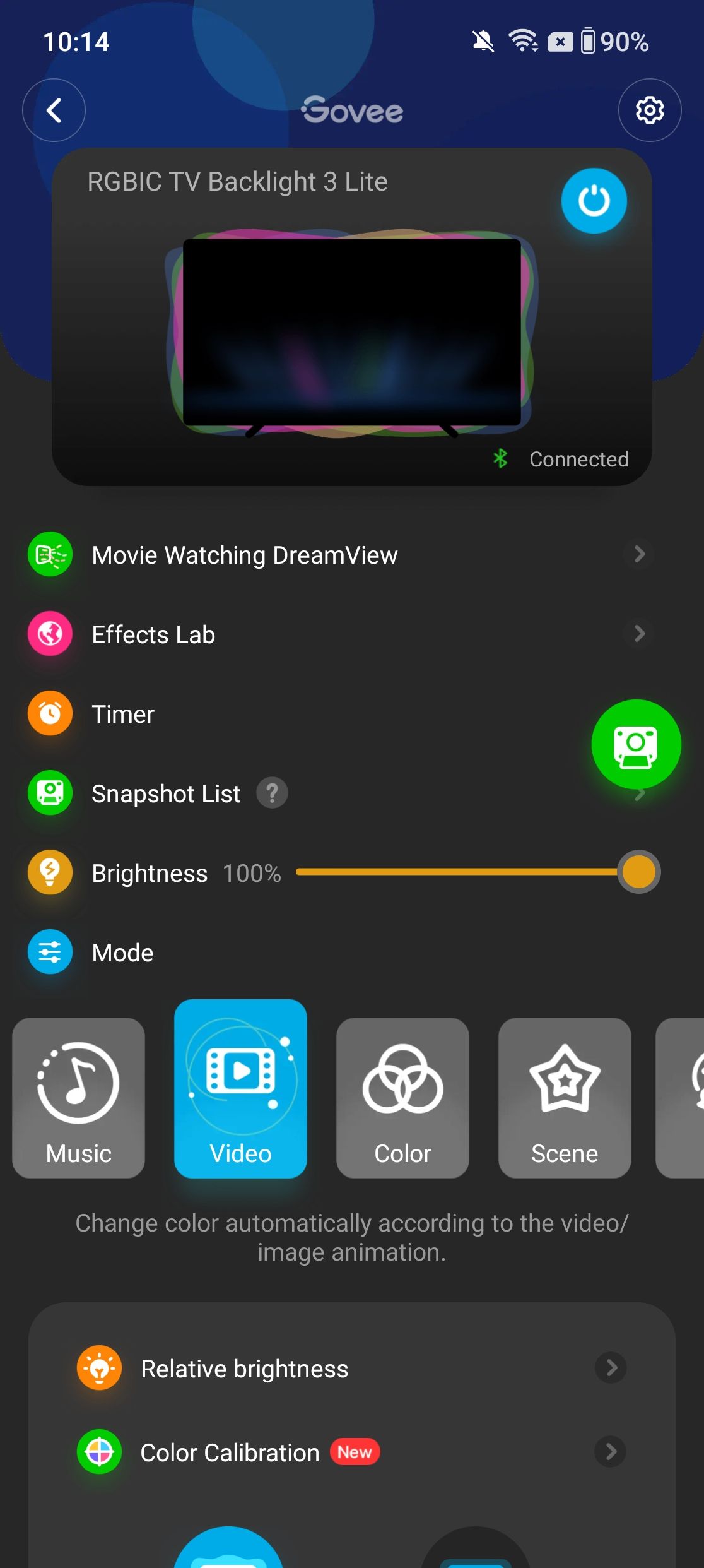

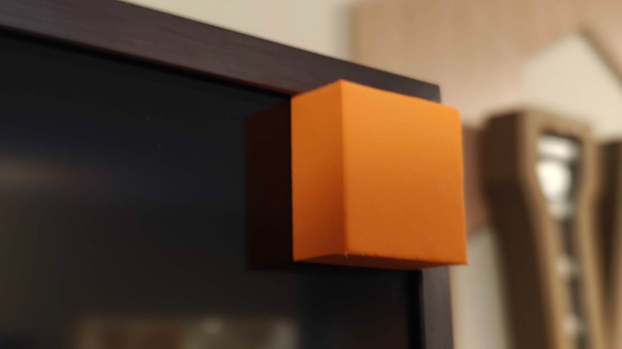

With this all done, it's time to go into the Govee app and get it all configured. The app does a great job of walking you through the process. It will have you stick the included orange foam square to your TV screen to help in the process. While it seems a bit odd to do, this is a very important step. The camera will take a still image of the display, and you'll manually move points on your phone screen to properly align what the camera sees to the edges of your TV with the squares as reference points.
Sticking adhesive foam squares to your TV seems odd, but it is important to ensure the Govee TV Backlight 3 Lite performs at its best.

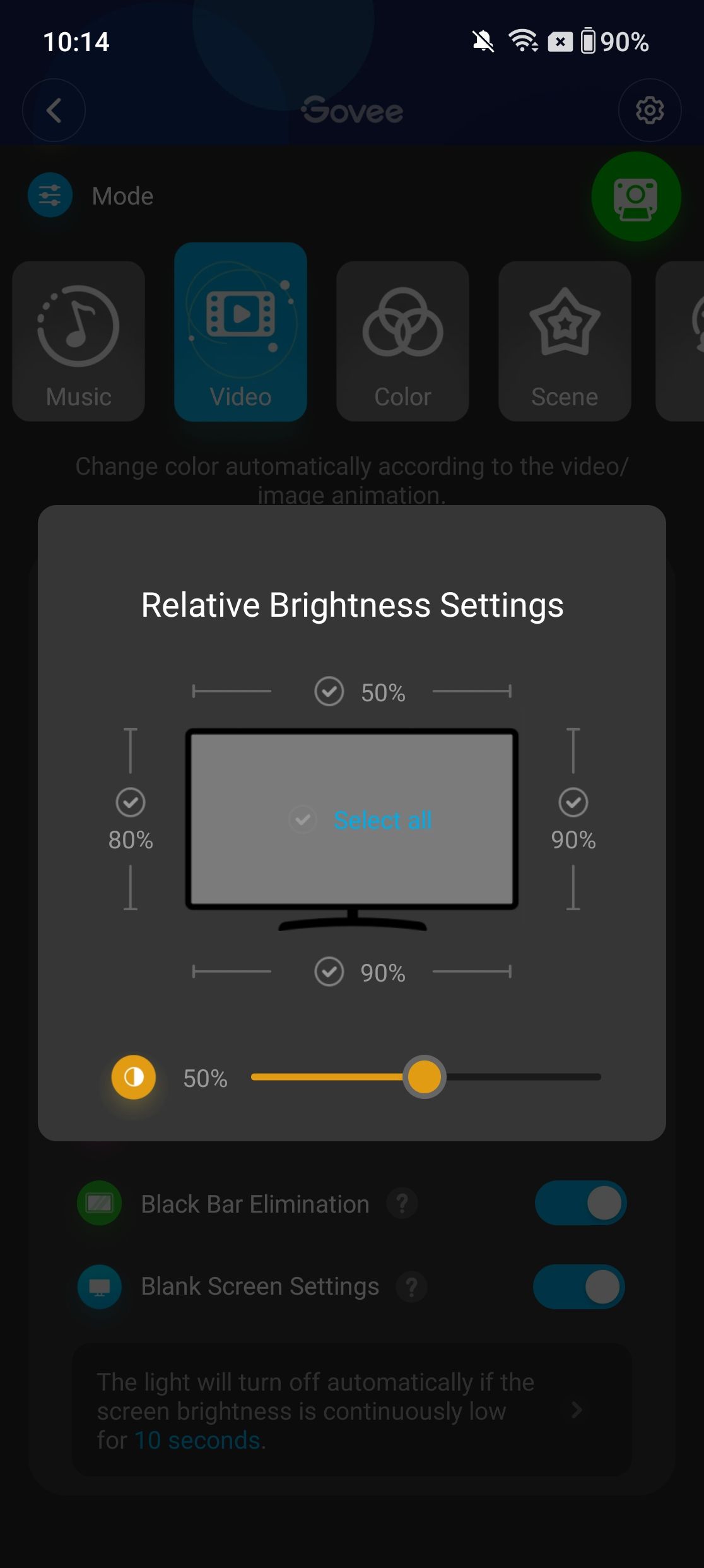

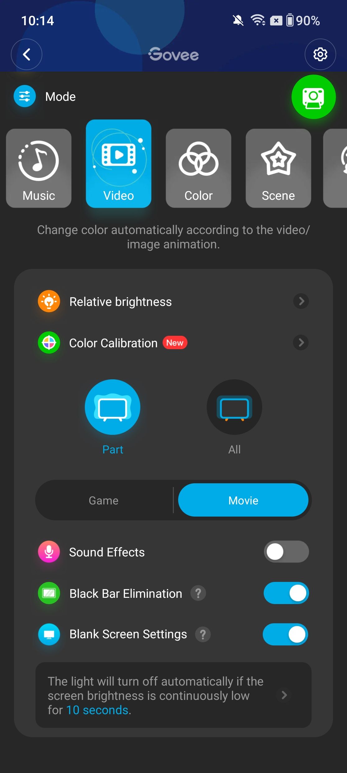

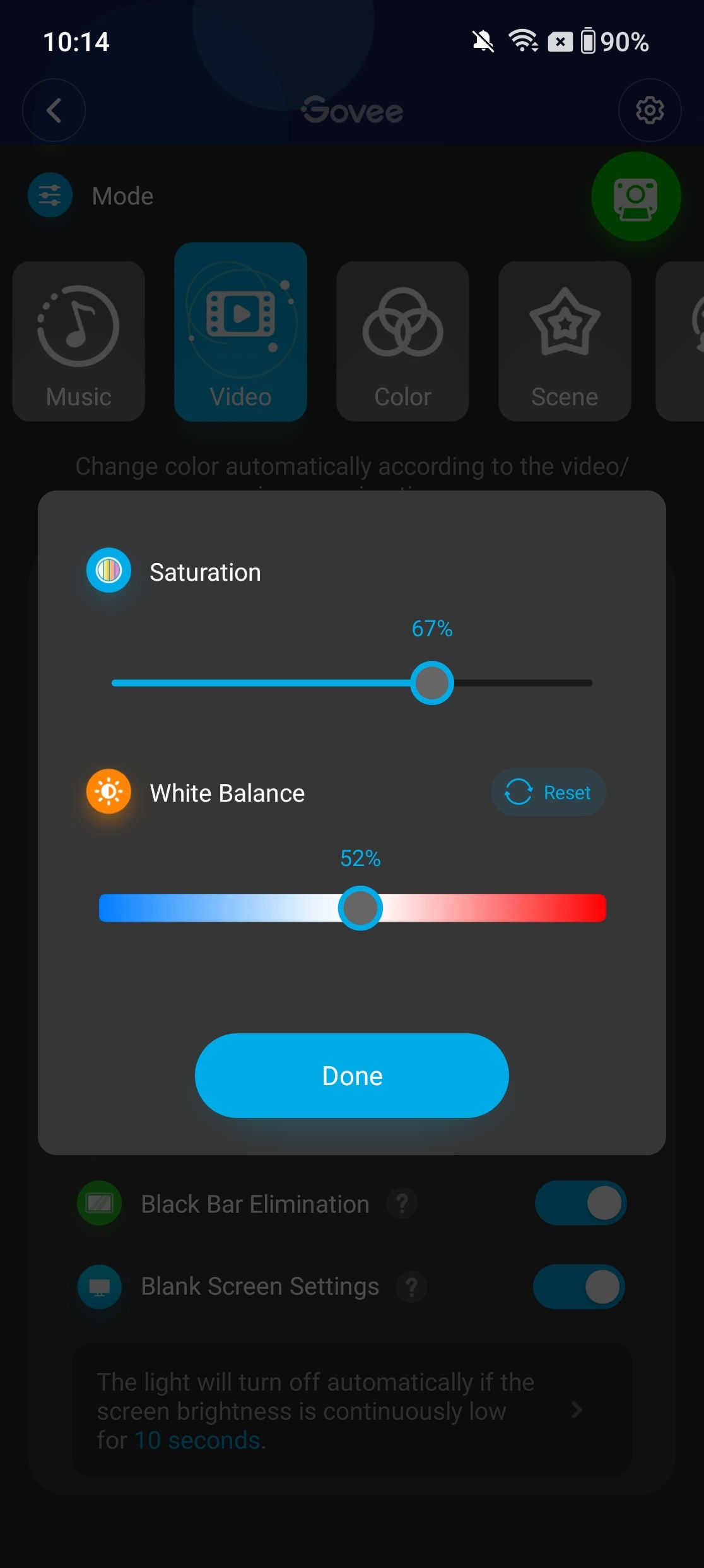

Lastly, though not new to the TV Backlight 3 Lite, Govee has added white balance adjustments, color correction, and relative brightness to different zones of the light strip. By using these options, you can better ensure the accuracy of the backlights during your TV viewing sessions.

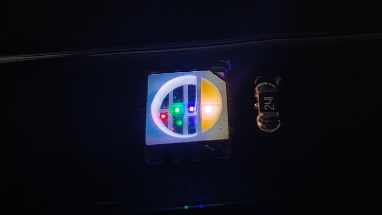

In my testing of the TV Backlight 3 Lite, it performs much like the rest of the excellent Govee smart lights. The colors represented by the RGBICW light strip are vibrant and reactive to what is being shown on screen. What helps this light strip stand out over the version shipped with the older Govee TV Backlight T2 is that W at the end. See, the new model gets a dedicated white LED to produce more accurate colors and true white tones. That said, the T2 light strip is brighter, and the camera does better at capturing what's on the screen.
