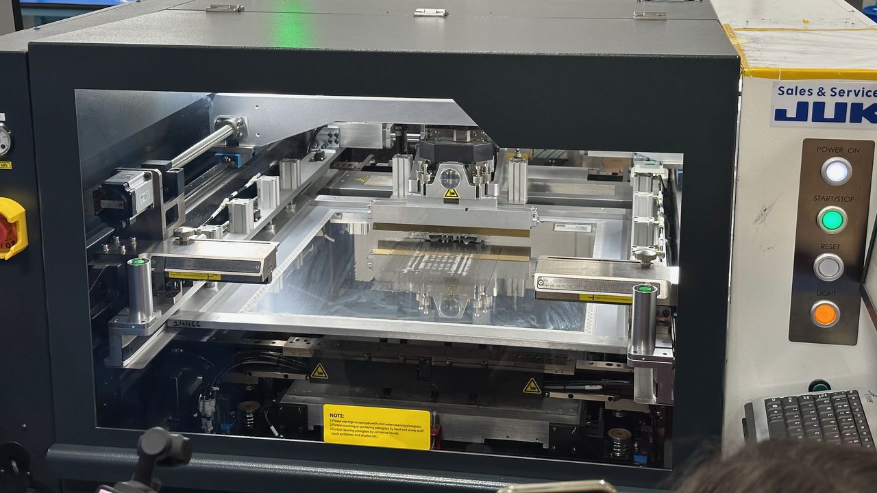

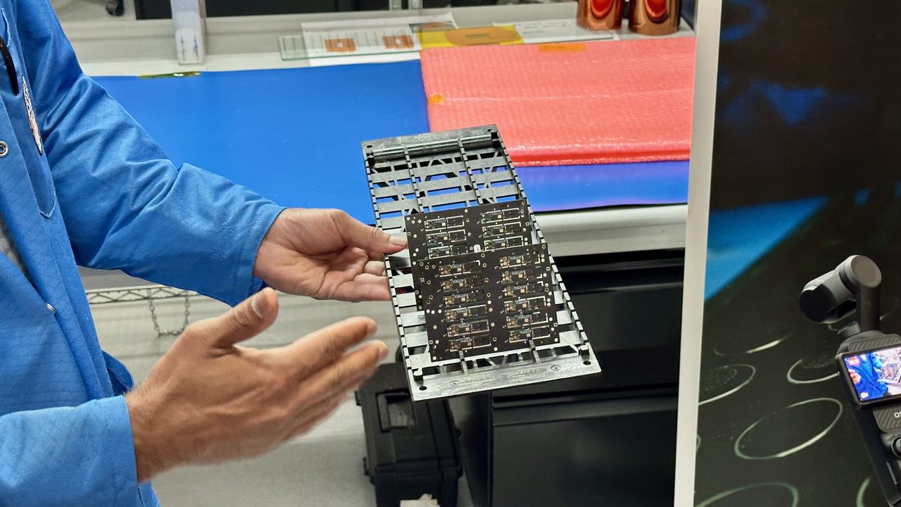

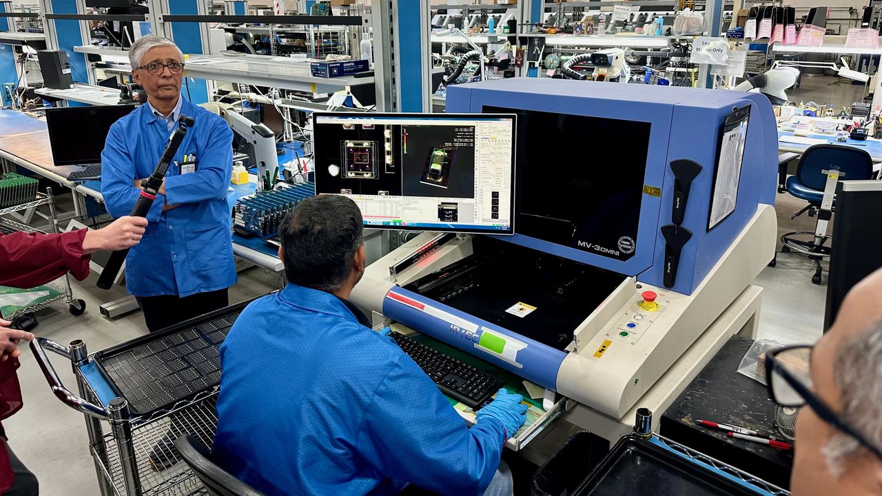

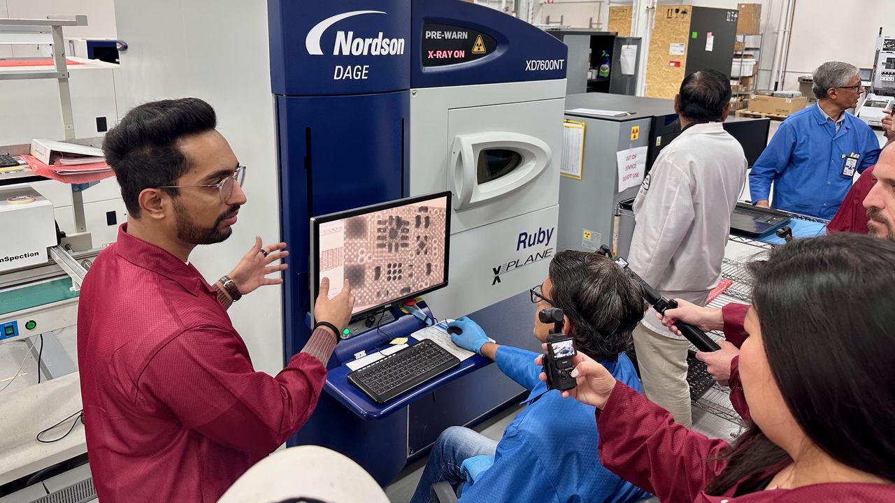

The photo galleries below show nearly every step of Ultrahuman's smart ring-making process, starting with the creation of printed circuit boards (PCBs), which contain the SoC, PPG, IMU, temperature, and Bluetooth components.
These components are mass-producible — an engineer suggested one machine could produce 10,000 PCBs in a day — and made of fiberglass, polyamide, and ceramic materials, chosen to make them bendable enough to slide naturally into the rounded ring shape.
But the "UltraFactory" currently only makes about 400 smart rings per day, though Ultrahuman has promised to hit about 1,350 per day or 500,000 per year by the end of 2025. There are several pain points, starting with the fact that the other mass-produced components have to be soldered onto the PCB by hand.

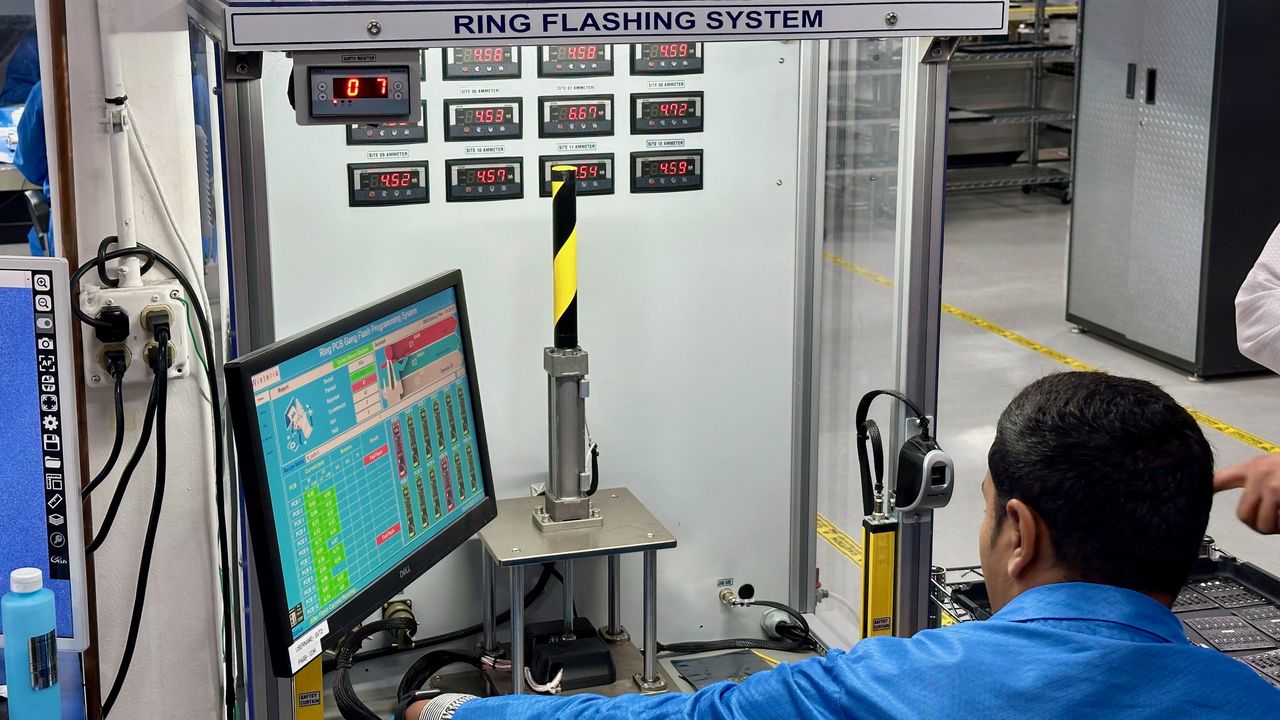

After they create the PCBs, do internal and external spot checks for any flaws, and program each PCB with the requisite software, they're ready for the next step: soldering.

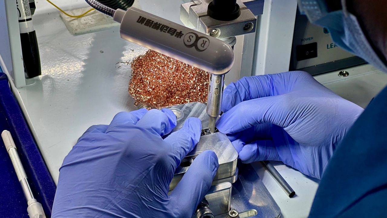

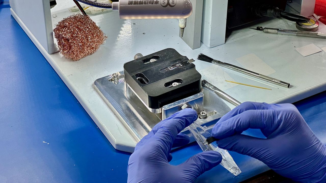

First, the Rx coil is soldered onto the PCB; then, the battery is soldered onto the coil. They brush off the excess alloy, leaving one seamless, bendable component ready to be inserted into the ring.

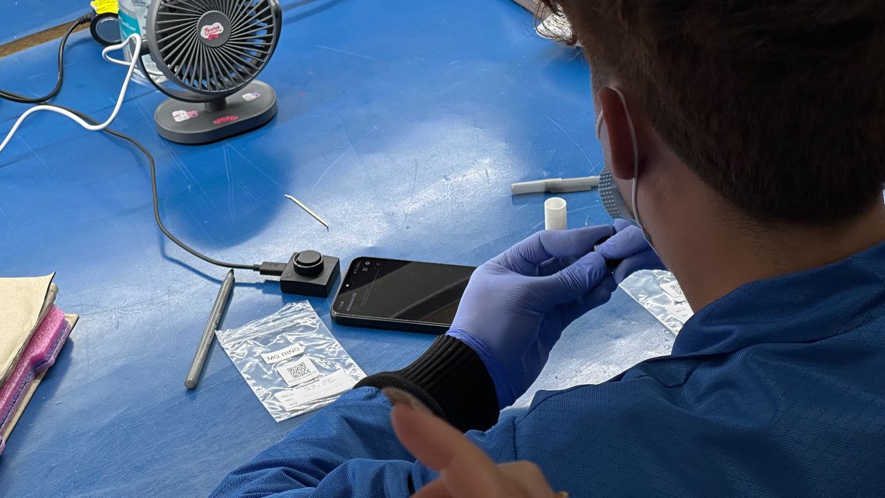

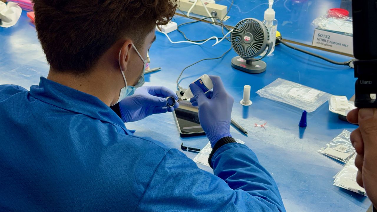

With a 3D-printed part, the welded-together PCB is curved into a proper J shape. The workers then apply glue to the titanium-carbon ring you're familiar with, remove the cover for the PCB's adhesive layer, and finally shove the component into place.

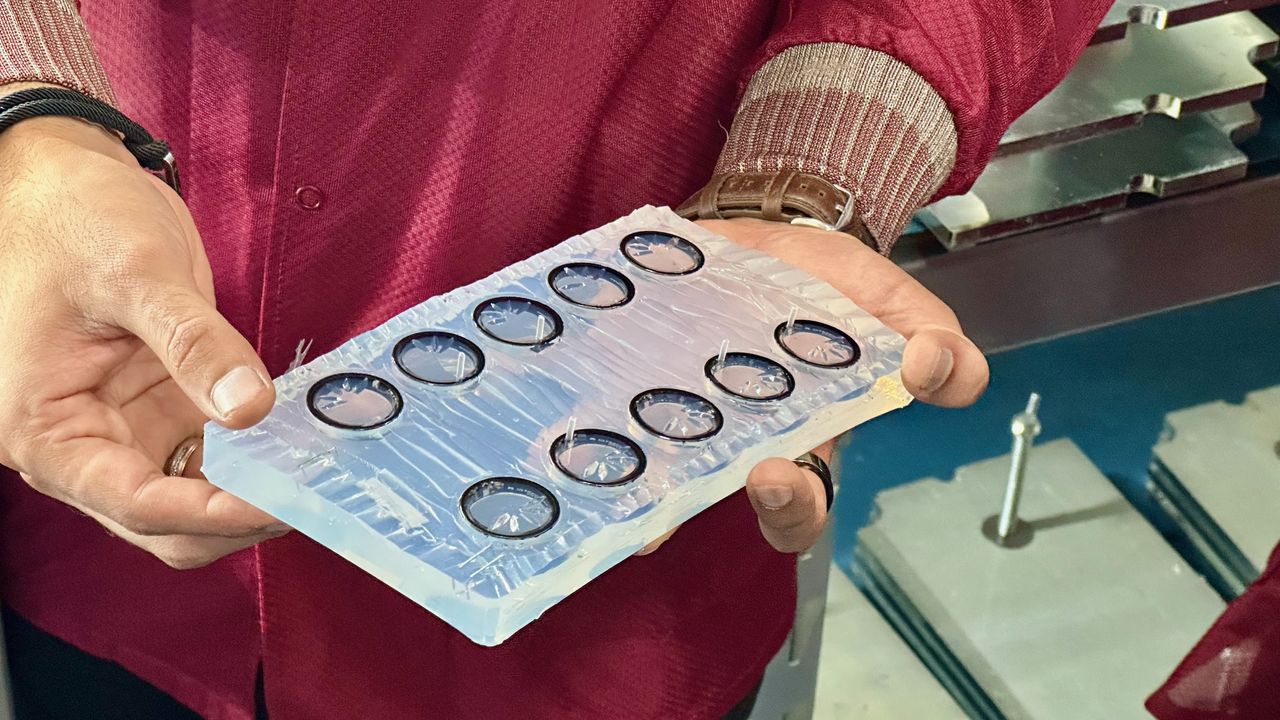

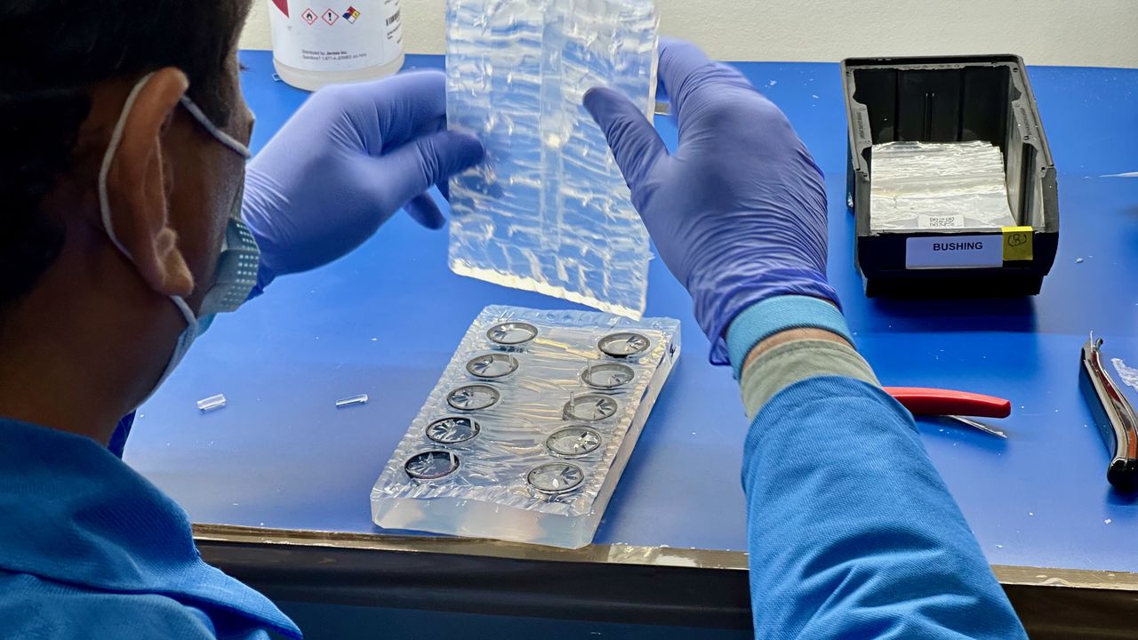

They do a software check — since technically, you could wear the ring at this point — and then place the ring inside a silicone mold. One mold with 12 rings is brought to the casting station, which is one part of the factory where they wouldn't let us photograph or record.
There, they inject epoxy resin into the ring from the thickest portion — the PPG — inside a vacuum-sealed chamber to prevent any resin bubbles. The process takes 24 hours, because heating the resin to harden it faster would damage the components. Ultrahuman said this casting process is one of the big pain points that slows down the ring process.

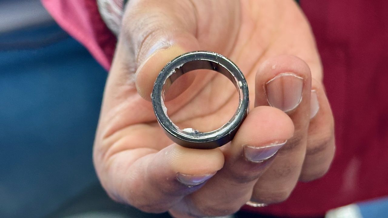

At this point, the smart ring is almost ready to be worn, but the resin will look rough and have hard edges that'll hurt your finger. They spend about 30 minutes cleaning and polishing it into consumer-ready form.
Once that's done, they do one more software check to ensure everything is up to code. Then, they place the ring on a 3D-printed part to check its size; if it won't fit or slides all the way down the cylinder, they know it's not to code. Otherwise, the Ultrahuman Ring Air is ready to be sold!

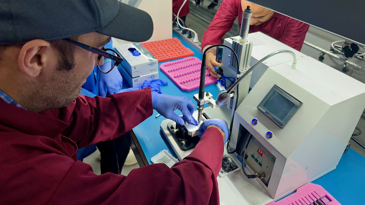

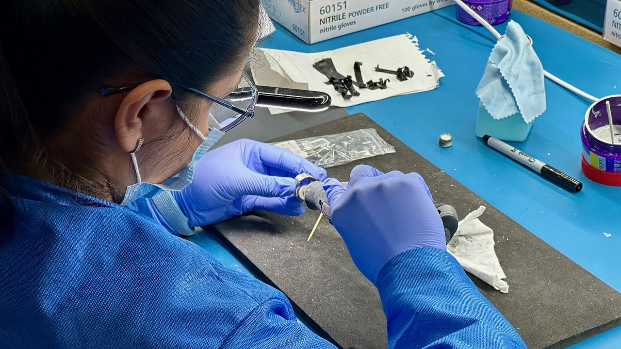

Following the steps above, I soldered the receiver coil onto the PCB by scraping some adhesive onto the coil and then stepping on a switch to trigger the machine (without burning off my thumbnail, thankfully). I then had to solder two separate points to attach the battery before brushing away the excess adhesive.

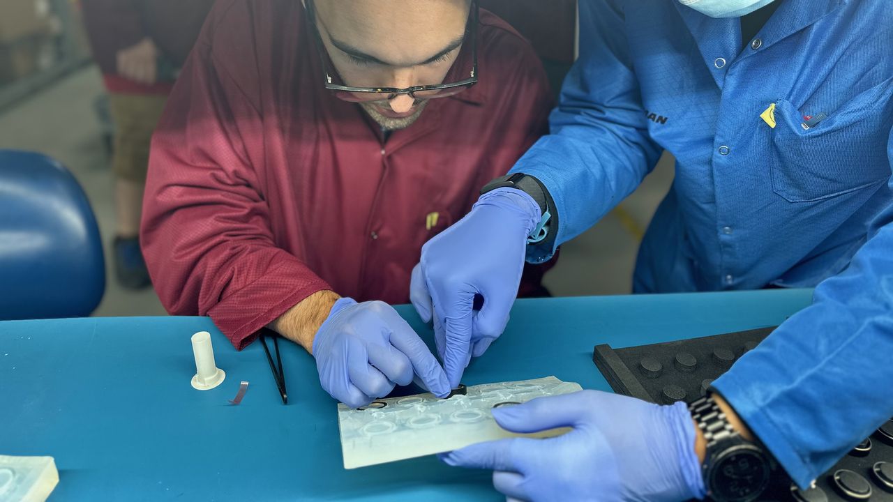

I curved the Ring Air components so they would fit inside, ripped off the adhesive with tweezers, shoved them inside the ring, and then pressed hard on the sensors to make them stick.
I was sure my clumsy, shaking fingers would break something, but it turned out my only issue was being too gentle. One portion came loose as I started to shove my smart ring into the casting mold, but I got it reattached and waved farewell to my ring.
Then they gave me another ring further along in the process and had me clean off the resin, using an electric spinning brush, sandpaper, and some 3M buffing fluid. I didn't get to finish the full 15+ minutes before Ultrahuman staff hustled me along to my interview, but I can honestly say I got that Ring Air into good enough shape that the resin wouldn't cut any fingers or look unsightly.

A series of PCB component sheets, with 12 PCBs per sheet to make 12 Ultrahuman Ring Airs.
